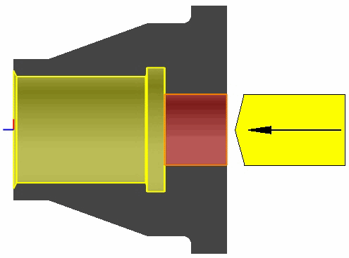

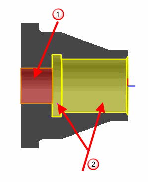

Recognized Hole — Several surfaces grouped together by PartMaker to make a hole on the solid. As well as recognizing a hole, PartMaker includes all cylinders that make at least a half circle.
Selected Wall Surface
— This is the surface you have selected (see
) on the solid model to be the Major Diameter of the hole.
Marked Surfaces
PartMaker uses these surfaces (see
) to calculate the
Depth and
Surf values for the hole.
PartMaker extracts the following data for hole groups:

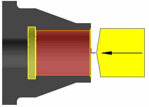

Through Hole — If, further down from the Major Diameter you selected, there is a diameter that is smaller than the Major Diameter, PartMaker does not classify the hole as a through hole. For example:
A through hole is created because there is no diameter further down the hole that is smaller than the Major Diameter.
A blind hole is created because there is a diameter that is smaller than the Major Diameter. The hole stops above the hole section where the diameter becomes smaller.

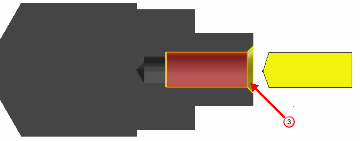

Chamfer
— If the surface directly above the selected wall of the hole is a cone that reduces in diameter,
PartMaker calculates this chamfer (see
) for the hole group. If there is no cone, or it is not directly above the selected surface,
PartMaker sets the chamfer value to zero.

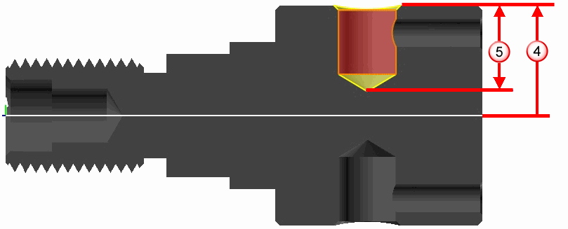

Surf
PartMaker finds the top of all of the selected surfaces, relative to the Face Origin, and uses this as the
Surf value (see
Depth
PartMaker finds the depth of all of the selected surfaces, relative to the top of the hole, and uses this as the
Depth
value (see
