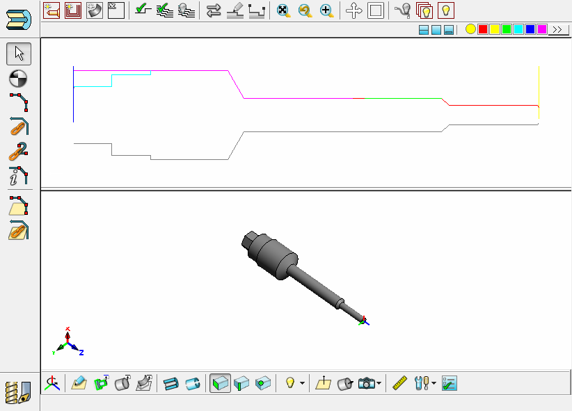

Face window with the Solids window — The Solids window is embedded in the Face window.

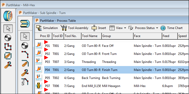

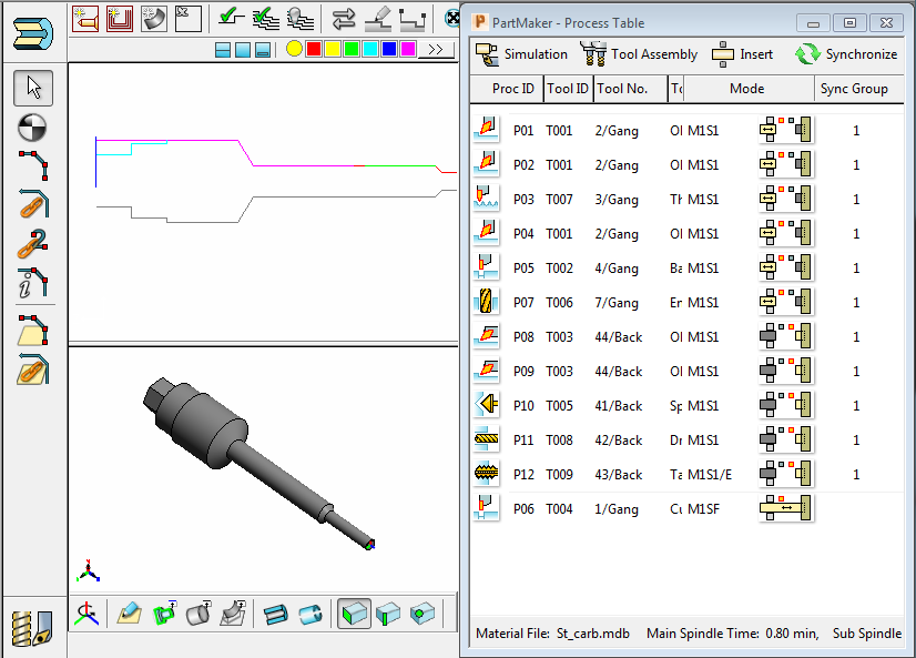

Face window with the Process Table — The Solids window may, or may not, be opened.
Use the following buttons at the end of the Main toolbar to work with a fixed Face window when it is arranged with other open windows:

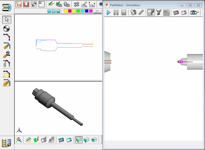

Face window with the Simulation window — The Solids window may, or may not, be opened.

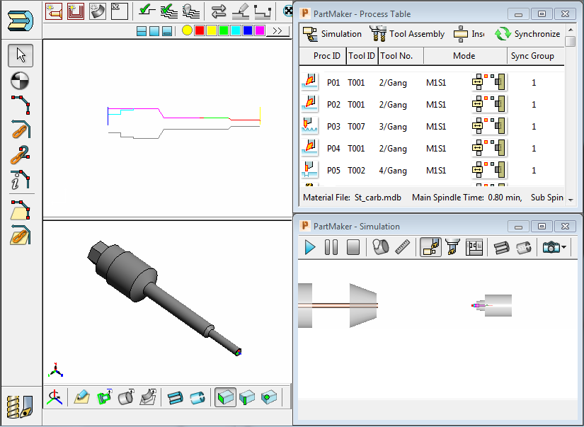

Face Window with the Process Table and the Simulation window — The Solids window, may or may not, be opened.
