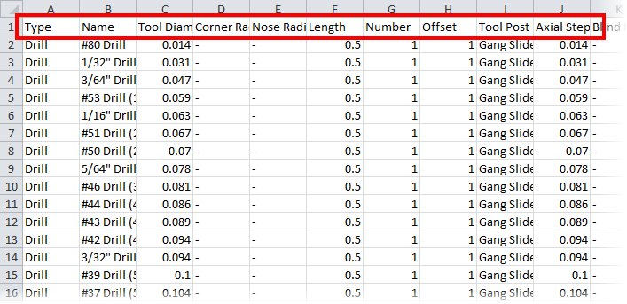

If your company has an existing master tools database in .csv format that has been created outside of PartMaker, Autodesk recommends the following process for converting this into a Master Tools Database file for use with PartMaker:
These parameter names will be translated into the language that PartMaker is currently using.
You do not need to change the order in which the parameters appear in the .csv file to match the order used in PartMaker's Master Tools Database file. Only the parameter names need to match.
Some parameters, such as Orientation for a turning tool, require a specific string value. To find out which string values are permissible for a particular parameter, look at the string values displayed on the Tool Data dialog or Edit Tool dialog and use the same string in the .csv file.
