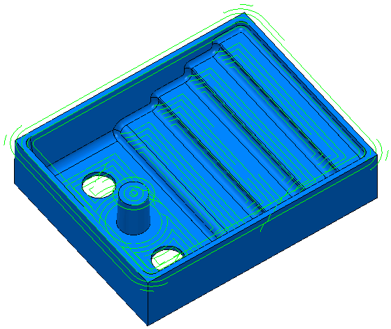

Offset flat finishing creates an offset toolpath on the flat areas of the model. Offset flat toolpaths are useful for finishing flat areas, the bottom of pockets and for high-speed machining.
This strategy supports Boundary curves.
More extensive flat machining options are available in the Model Area Clearance strategy.
