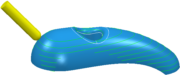

Enter the angle of the tool from the vertical when using a Tool axis of Lead/Lean. The tool is at a fixed angle relative to the local normal to the toolpath. The local normal is going to vary as you go along the toolpath, at each point of the toolpath and relative to the direction of the toolpath at each point.
You can specify two different angles - Lead and Lean. If you specify both a Lead and a Lean angle, the Lead Angle is applied first in the direction of the move, and then the Lean Angle is applied from this rotated position towards a vector perpendicular to the move.
Lead — Enter the angle of the tool axis in the direction of travel. It is measured from the perpendicular to the direction of travel. 0
is vertical. Typically, this is used to avoid cutting at the center of a ball nosed tool on flattish areas. A typical
Lead Angle is 15
Lead angle, which is in the direction of travel. In this example the angle is in the ZX plane.
Direction of travel.
Lean — Enter the angle of the tool axis at right angles to the direction of travel. 0
is vertical. Typically, a
Lean Angle is used to avoid the tool holder colliding with the part, to avoid collisions caused by a step, or to allow you to use a smaller tool when machining up to a step.
Lean angle, which is perpendicular to the direction of travel. In this example the angle is in the YZ plane.

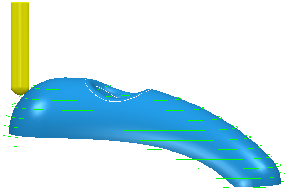

This example uses a constant Z toolpath with a Tool axis of:
Lead angle of
0
Lean angle of
0
Mode of Vertical.

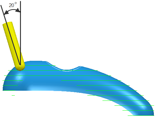

Lead angle of
20
Lean angle of
0
Mode of Vertical.

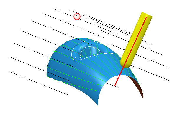

This example shows a toolpath with a Tool axis of:
Lead angle of
0
Lean angle of
0
Mode of Frame Normal.
Preview frame
The tool is normal to the preview frame.

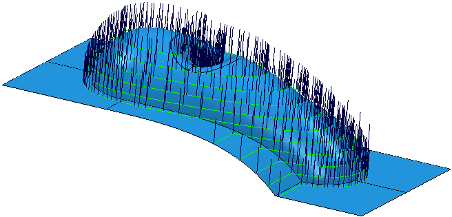

The effect of this option is visible when you select Solids > View > Draw Tool Axes.
A Tool axis of Vertical and a Fixed angle of None gives:

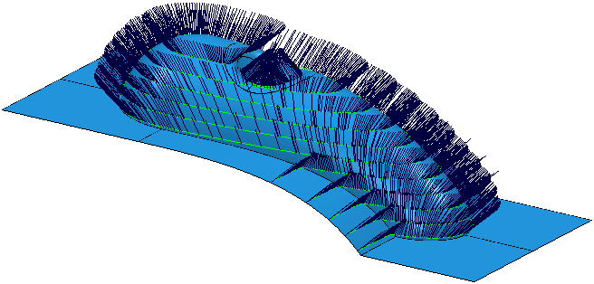

A
Tool axis of
Vertical and a
Fixed elevation angle of
45
gives:
