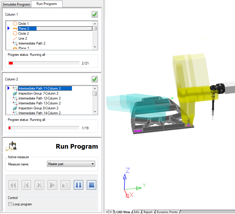

In dual-column mode, the items associated with each column are displayed in separate sections of the Run Program tab. This enables you to control which columns are running, to view the progress of the inspection on each column when they are running simultaneously, and to specify separate ranges for each set of items. By default, the CAD view also displays the predicted movements of each column so you can check their relative positions and avoid potential collisions.
To run the inspection sequence:
button of the column you do not want to use.
The Run Program tab displays the progress of each column through the inspection sequence, and the CAD view displays the moves of the column you selected, plus an envelope of the predicted moves for each column. For example:
When you have verified the inspection at operating speeds, you can turn off collision prediction by deselecting the Perform collision prediction check box in the Online Collision Prediction Configuration dialog.
