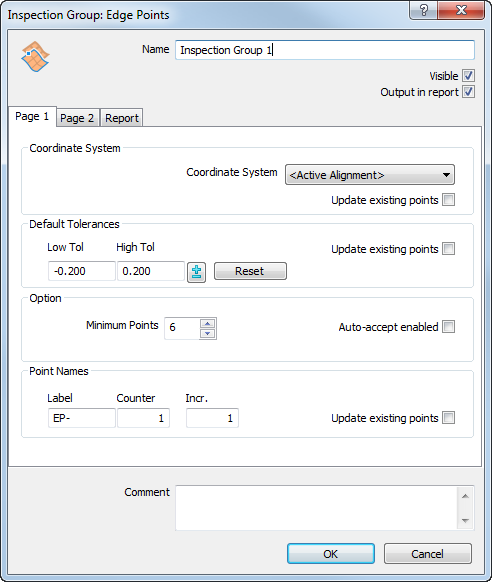

Use the Inspection Group: Edge Points dialog to specify the details of an On-the-fly Edge group.
To display the dialog, double-click the group's name in the Sequence Tree.
The dialog contains the following settings:
Name — Enter a name for the item. The name is used in the inspection sequence, in the Report and Info tabs, and when referencing the item in other items.
Visible — Select this check box to display the item in the CAD view.
Output in report — Select this check box to include the item in the report.
Coordinate system — Select the alignment relative to which the item's measurements are to be reported.
To specify the alignment during the inspection, select <Active Alignment>. You can then select the alignment from the Active alignment list, or by adding an Active Alignment item to the inspection sequence.
Update existing points — Select this check box to apply the selected coordinate system to items already in the group.
Default tolerances — Enter the maximum distances from the nominal surface at which points are in tolerance. Select the Update existing points check box to apply the values to points already in the group.
Select Reset to revert to the defaults specified in the Measure Parameters dialog.
Option — Enter the Minimum Points required to measure the feature. The group is treated as unmeasured until at least the specified number of points is probed. Select Auto-accept enabled to save the points as soon as you have probed the specified number of points. This setting has no effect when you specify a probe path for the group.
Point names — Enter a Label, Counter, and Incr to control the naming of points added to the group. Select the Update existing points check box to apply the rules to points already in the group.
To base the labels on the name of the surface the points are projected onto, select the Use surface projected onto as point name prefix check box in the Surface Inspection page of the Options dialog.
Select the Update existing points check box to apply the changes to existing points. For example:
Comment — Enter any notes and extra information about the group.
Default offset — Enter values to compensate for the thickness of the part. Positive values offset nominals towards the probe.
Select the Update existing points check box to apply the values to points already in the group. Select Reset to revert to the defaults specified in the Measure Parameters dialog.
Custom levels — By default, PowerInspect projects the inspection points onto the nearest surface. To exclude surfaces from use, select the Use custom levels check box, and click Levels. Select the Update existing points check box to apply the exclusions to points already in the group.
To specify the surfaces that can be used for this group:
to expand the folders and display the CAD level and object entries.
Edge — Select this option to inspect a flat edge.
Hem edge — Select this option to inspect a rounded edge, and enter the inner radius of the hem in Radius box.
Report — Select this tab to specify the layout settings of the inspection group in the report: Select:
Click OK to close the dialog and save your changes.
