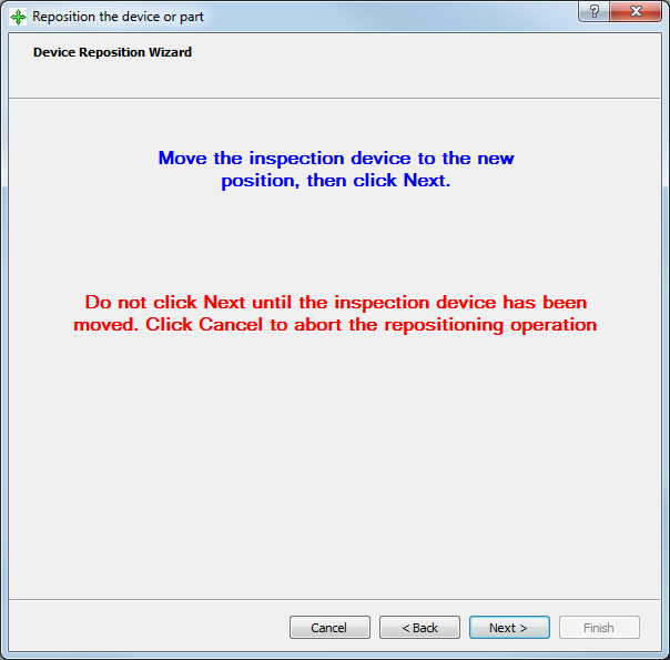

When you reposition a part or device, PowerInspect matches measurements taken before and after the move, and uses them to create a transformation. This transformation is automatically applied to all measurements made after the repositioning, and enables you to continue the inspection in the original coordinate system.

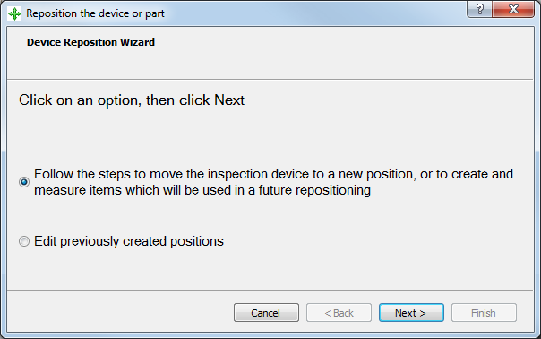

To create a new position:
button. The

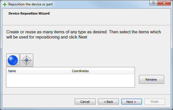

Sphere — Click this button to create a sphere item.
Point — Click this button to create a point item. You must use a rigid probe to measure points.
By default, features are numbered sequentially, starting with Item 1. To rename an item, select its entry in the list, click Rename, and then type the new name.
To delete an item, right-click the entry, and then select Delete from the context menu. In the confirmation dialog, click OK.

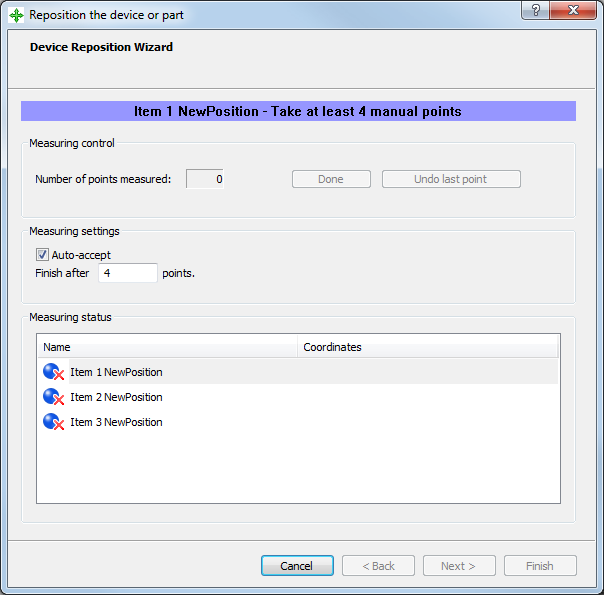

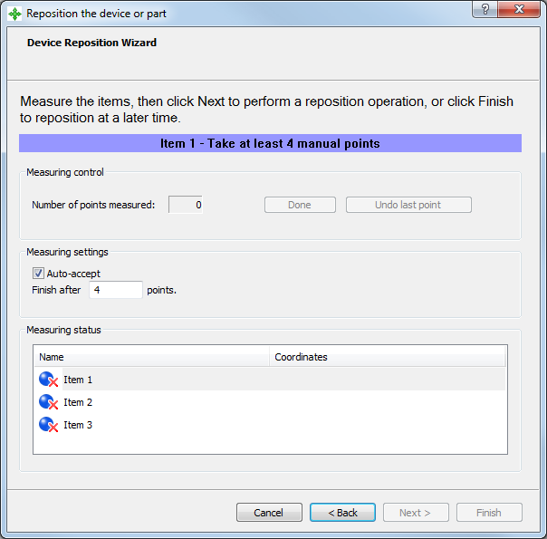

Alternatively, select Auto-accept, enter the number of points required to measure a sphere, and probe the item. PowerInspect automatically saves the measurement when you have probed the specified number of points.
To reset the measurement status of an item, right-click its entry in the list and select Set unmeasured from the context menu.

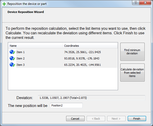

The Deviation area displays the total deviation between the new and original positions of the selected items.
