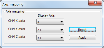

Axis mapping enables you to match the DRO axes to the axes of the measuring device.
To change the axis mapping for the DRO:
Each display axis can be used only once. If you use an axis more than once, a warning message is displayed when you apply the settings.
In the following example, the part's Y axis is aligned with the CMM's Z axis; the part's Z axis is aligned with the CMM's Y axis; and the part’s X axis is aligned with the CMM X axis, but in the opposite direction.
You can correct the values displayed in the DRO using the following axis mappings:
