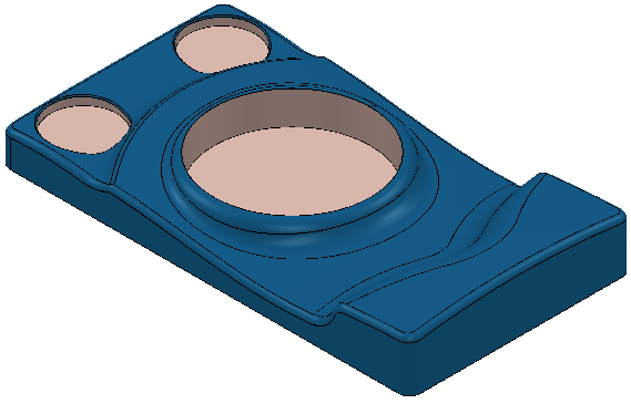

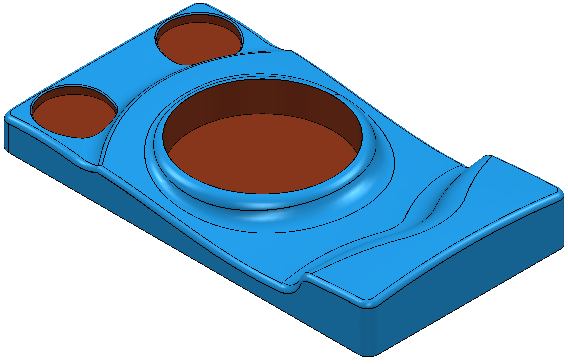

- Select Visible Reversed Components — Click to select the reversed components in the current view orientation.
For example, reversed components not selected appears as:
Using the option, the selected reversed components appear as:
You can use this with Reverse Selected (on the Model context menu) to reverse all the incorrectly oriented surfaces. The quality of the selection depends on the quality of the model. When using this option, if there are gaps in surfaces which reveal inside surfaces, those surfaces are also selected.
