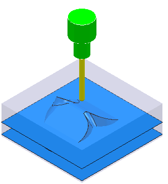

- Click Close. The tool and tool shank are displayed in the graphics window:
