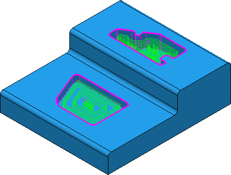

Use the
Feature Pocket Area Clearance strategy to efficiently remove large volumes of material for individual pocket features using one strategy. This strategy enables you to machine multiple pockets at different Z levels.
