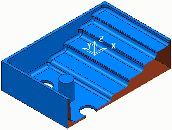

X — The clipping planes are parallel to the X axis of the current workplane.

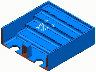

Y — The clipping planes are parallel to the Y axis of the current workplane.

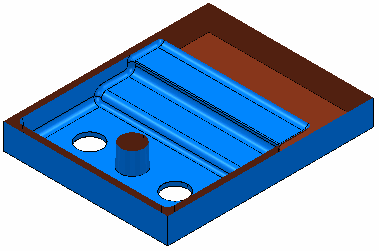

Z — The clipping planes are parallel to the Z axis of the current workplane.
