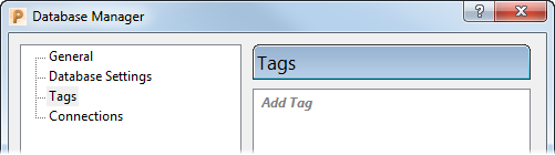

- In the tree, select Tags to display the Tags page.

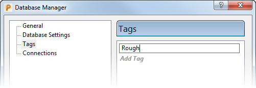

- Create a tag:
- Double-click Add Tag.
- Enter a tag name.
- Press the Enter key to display the tag in the list.
- Click Close.
Note: To delete a tag, on the
Tags page of the
Database Manager dialog, select a tag from the list and click
