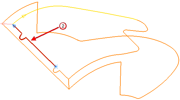

- Double-click on the curve, near point
, to display the
Curve Editor tab.
- Click Curve Editor tab > Create panel > Curves > Composite to display the
Create Composite Curve toolbar.
- Click the curve near point
- Red indicates the selected curve.
- Pink indicates the curve that automatic sketching follows.
- Yellow indicates an alternative route.
- Click the yellow curve.

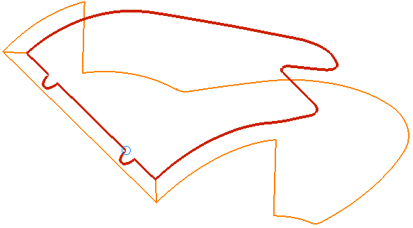

- Click
on the
- Click Curve Editor tab > Finish panel > Accept.

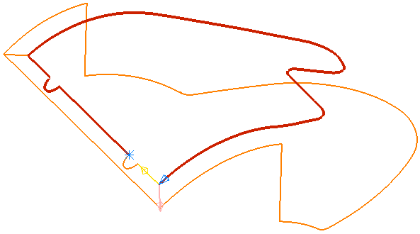

Note: If, before step 3, you selected a
Direction of
, you can click
on the
Create Composite Curve tab to create the automatic path.
