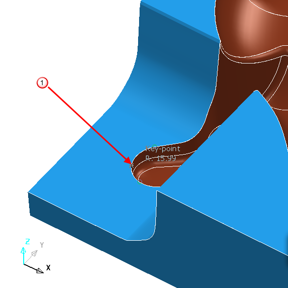

This example shows you how to measure the radius of an arc. It uses the chainsaw.ige model in the Examples folder.

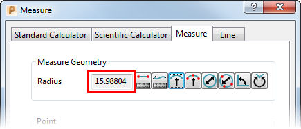

- Click Home tab > Utilities panel > Measure to display the
Measure dialog.
- Click Radius
to display the Measuring Tools tab.
- In the graphics area, click point
This displays the Measure dialog with the radius displayed.
Note: This gives the radius of the curve at that point. If you want to approximate a longer length of curve to a circle use
