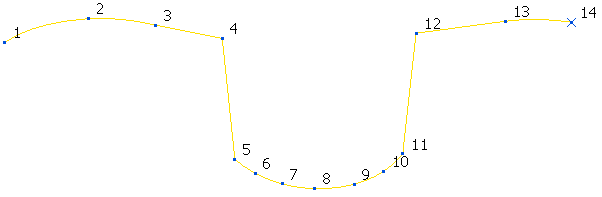

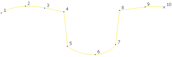

- Repoint between — Determines which portion of the Bézier curve you want to redistribute. For an example, see Reducing the number of points in a curve.
Start point
End point
With a Number of points in range of 3 this replaces points 6 – 10 with one point here.

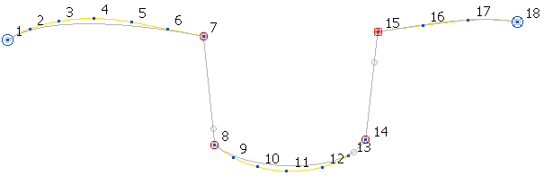

- Select Discontinuities — Click to select the points with tangent discontinuities (where the tangent before the point is different to the tangent after the point).
In this example:
Clicking on Select continuities selects points 7, 8, 14, and 15.
