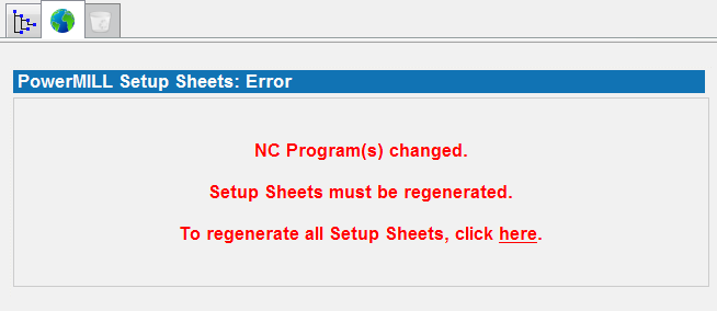

If you've modified an NC program after previewing the setup sheets (for example, removed or added a toolpath, re-written a program and so on),
PowerMill creates an HTML page with a warning that the setup sheets are out of date.
Note: When you modify an NC program that is already post-processed, the NC icon changes from green
to grey
to indicate that it is modified.
Clicking on the provided link updates the setup sheets to reflect the NC program change.
Warning: No warning is issued if you've exported the setup sheets and then modified an NC program.
