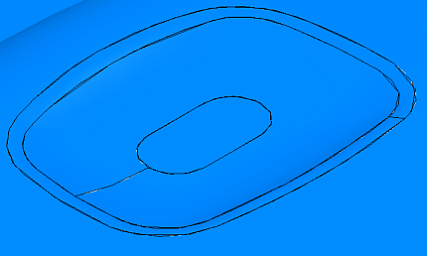

- Zoom to Box — Click and then use the left mouse button to drag a box over a section of the graphics window to zoom into the specified area. For example:
It converts this:
Zoom box
to this:
