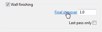

This example shows how to calculate values in a dialog. It enters a value into the Wall finishing page of the Model Area Clearance strategy dialog.
In this case, the desired Final stepover is the length between two points on the model. This distance is determined using the Measuring Tools tab:
- Click the Final stepover hyperlink.

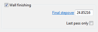

- Selecting the second point closes the Measuring Tools tab and enters the measured length into the Final stepover field:
