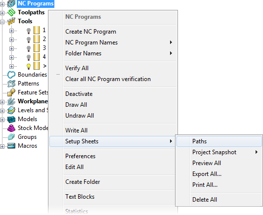

  1. From the NC Programs context menu, select Setup Sheets > Paths.
