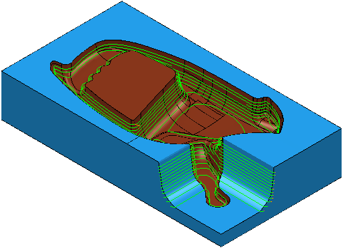

Model Rest Profile strategy to eliminate large terraces. Area clearance strategies carry out efficient volume removal with a large tool and then rest area clearance strategies use a smaller tool to machine the model profile at each intermediate Z height of the model. this machines areas the large tool could not reach, such as pockets and corners. This reduces the degree of tool overload and provides a more constant material removal rate for subsequent finishing operations.

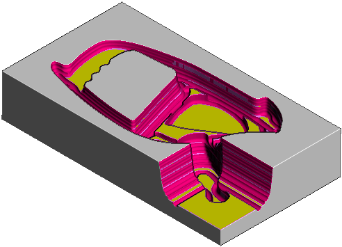

This is easier to see looking at a ViewMill simulation.
If you start with an area clearance toolpath:
A model rest profile area clearance toolpath, based on this area clearance toolpath, gives:
