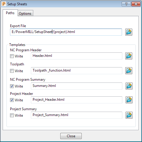

In the Setup Sheets dialog which appears, select the Paths tab.Initially, the default templates set is chosen, and the Write check boxes are selected for all templates. You can:
- Keep the default template set, and use the Write check boxes to specify which templates should be used to create setup sheets. For example, if you only need a project-specific header page and the NC program summary sheets, deselect the Write check boxes for Header.html, Toolpath.html, and Project_Summary.html.
- Select your own template set, and use the Write check boxes to specify which templates should be used.
