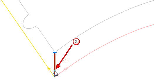

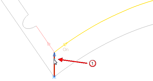

The forward direction points to the curve-end closest to the selection point. So, selecting the curve at point , gives a forward direction of upwards.
Selecting the curve at point , gives a forward direction of downwards.
