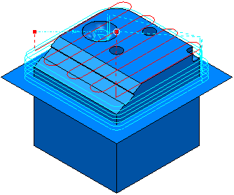

- Adjust the CAD view of the model to the required size and orientation.
- From the individual NC Program context menu, select Setup Sheets > Snapshot > Enter Snapshot Mode. This displays the Snapshot tab and the background turns white.

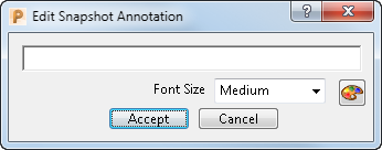

- Click in the Graphics window. This displays the Edit Snapshot Annotation dialog.

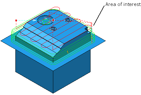

- Enter the relevant text, such as Area of interest, and click Accept. This adds the text to the graphics area.
- Move the text by placing the cursor over it, the cursor changes to
and drag it to the required position.
- Draw a line by clicking and dragging in the graphics window.
