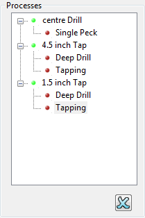

You have created a Drilling method with drilling processes for drilling and tapping two sizes of holes on the model. Expand Processes on the Drilling methods dialog to view them.
