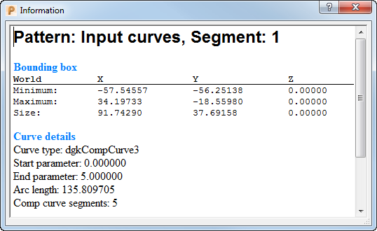

- Properties — Select to display the extents, type, and key points of the curve.
Pattern — Displays the name of the pattern, in this case Input curves.
Segment — Displays the properties of this segment. In this case the first segment.
