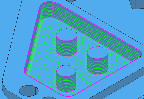

Use the Feature Finishing strategy to perform finishing or semi-finishing passes on the walls and flats of pocket and boss features.
