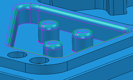

Use the Feature Top Fillet Milling strategy to machine fillets along the outside edges of features, where the fillet information is specified by the feature geometry. Feature top fillet milling is used to:
- break sharp outside-edges of a model after it has been completely machined
- minimise hand deburring operations
- make aesthetic improvements.
