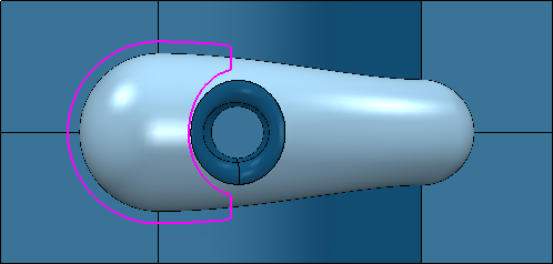

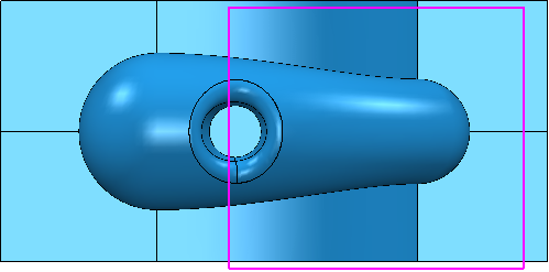

- Create a simple
User Defined Boundary:
- Create a
Selected Surface Boundary with:
- Limit Boundary selected.
- The user defined boundary as your
Limiting Boundary.
- Inside
selected.
- Selecting
Outside, rather than
Inside produces:
