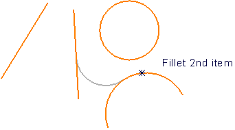

- Fillet — Click to fillet and trim two curves, or all the sharp corners within a composite curve to a specified Radius. Fillets are possible between:
- two lines.
- a line and an arc.
- two arcs.
Circle
Arc
Circles are not trimmed, but arcs are. The filleted curves are not merged into one curve. The only exception is if a continuous line is filleted.
- Fillet no trim — Click to fillet, without trimming, two curves, or all the sharp corners within a composite curve to a specified Radius.
Fillets are always trimmed when you select a continuous line. Apart from trimming, this works in the same way as Fillet.
