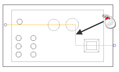

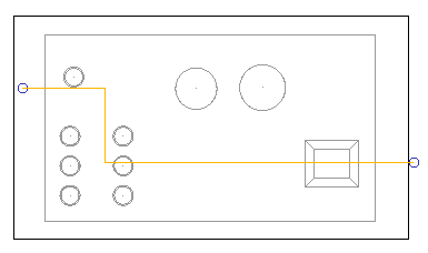

To edit a section line during creation:
- Click on the section line:
- Drag the line to a different position:

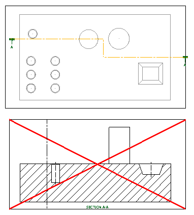

To edit a section line after a section view has been created:
- Double-click on the section line to display the Section Line toolbar.
- Click and drag the line to a different position.
The section view displays a red cross to show that the view is out of date because the section line has been changed.
- To update the section view, right-click the view and select Update.
