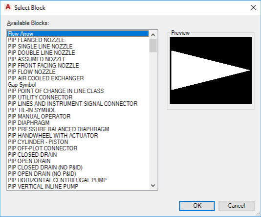

- In the Select Block dialog box, under Available Blocks, select a block. Click OK.
