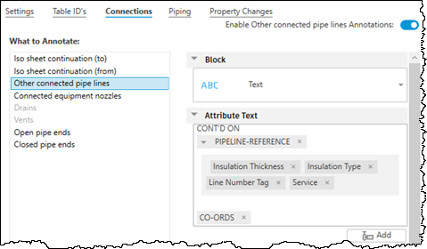

Connections Tab
Specifies which end connections are displayed for the selected iso type. 
Enable <Type> Annotations
Controls the display of the annotation.
What to Annotate
Specifies which end connections coordinates are displayed for the selected iso type. These are following options:
  • Iso sheet continuation (to)
  • Iso sheet continuation (from)
  • Other connected pipe lines
  • Connected equipment nozzles
  • Vents
  • Drains
  • Open pipe ends
  • Closed pipe ends
  • Note: Iso Sheet Connection (to) and  Iso Sheet Connection (from) only work through a split. Non-split connections annotation should use Other connected pipe lines.
Block
Specifies the shape of the enclosure, circle, rectangle, diamond, hexagon, or oval. You can also choose not to have any enclosure or other blocks from IsoSymbolStyles.dwg.
Scale Enclosures to Fit Text
Expands graphics to accommodate annotation text. Some enclosure symbols always expand. 
Attribute Text
Specifies the connection text. You can add text, add properties from classes or PCF, or add symbols. You can also specify whether coordinates and elevation information is added to the annotation.
Note: You can expand PIPELINE-REFERENCE for Other connected pipe lines or CONNECTION-REFERENCE for Connected equipment nozzles to add properties.
Leader
Specifies whether a leader line connects the object to its annotation, with or without an arrow. You can also choose never to use a leader.
Connect to Annotation
Specifies the leader line to connect to the corner, middle, or center of the annotation.
Connect to Component
Specifies the leader line to connect to the middle or end of the component.
MLeader Style
Specifies which multileader style is used.
Use Leader Landing
Specifies whether to use leader landing.
Placement
Displays annotations to be always horizontal, rotate with piping, or to show in iso plane.
Position (relative to piping)
Specifies the annotation is placed above or below the piping, or anywhere.
Group with Related Annotations
Specifies whether to group annotation with the related annotations.
Prioritize when Grouped
Specifies whether to prioritize current annotation when all annotations are grouped together.
