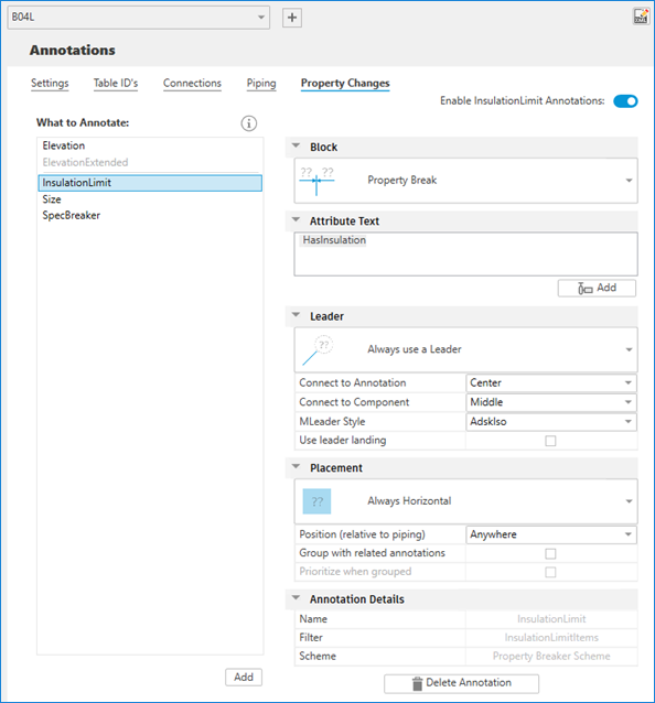

Property Changes Tab
Specifies property change information to identify locations where piping properties have changed or reached a limit.
Create and customize property change annotations with the display settings.
Enable <Type> Annotations
Controls the display of the annotation.
What to Annotate
Lists existing property change annotations defined in IsoConfig.xml. You can also add new property change annotations.
Block
Specifies the shape of the enclosure, circle, rectangle, diamond, hexagon, or oval. You can also choose not to have any enclosure..
Scale Enclosures to Fit Text
Expands graphics to accommodate annotation text. Some enclosure symbols always expand. 
Attribute Text
Specifies the property for property change annotations. Choose any property from classes or PCF as the identifier for the property change annotation. You can also add text or symbols.
Note: You can’t replace property for Elevation, ElevationExtended, and InsulationLimit annotations.
Leader
Specifies whether a leader line connects the object to its annotation, with or without an arrow. You can also choose never to use a leader.
Connect to Annotation
Specifies the leader line to connect to the corner, middle, or center of the annotation.
Connect to Component
Specifies the leader line to connect to the middle or end of the component.
MLeader Style
Specifies which multileader style is used.
Use Leader Landing
Specifies whether to use leader landing.
Placement
Displays annotations to be always horizontal, rotate with piping, or to show in iso plane.
Position (relative to piping)
Specifies the annotation is placed above or below the piping, or anywhere.
Group with Related Annotations
Specifies whether to group annotation with the related annotations.
Prioritize when Grouped
Specifies whether to prioritize current annotation when all annotations are grouped together.
Delete Annotation
Deletes the current piping annotation.
Note: Elevation and ElevationExtended annotations cannot be deleted.
