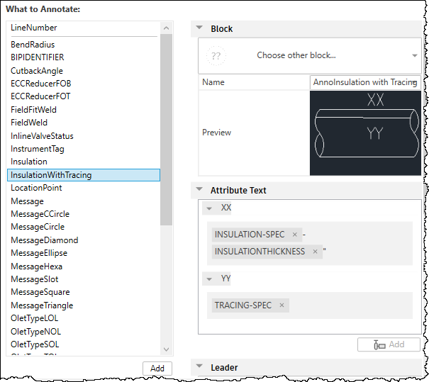

What to Annotate
Lists existing piping annotations defined in IsoConfig.xml. You can also add new piping annotations.
Block
Specifies the shape of the enclosure, circle, rectangle, diamond, hexagon, or oval. You can also choose not to have any enclosure..
Scale Enclosures to Fit Text
Expands graphics to accommodate annotation text. Some enclosure symbols always expand. 
Attribute Text
Add properties for piping annotations. You can add text, add properties from classes or PCF, or add symbols.
LineNumber
You can expand PIPELINE-REFERENCE and the component field for LineNumber to add properties.
InsulationwithTracing
For blocks containing multiple properties, you can also expand the property names to add properties individually.
