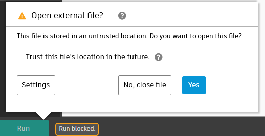

Dynamo will not run an untrusted graph. When a graph from an untrusted location is opened, Dynamo will show a warning, and the run will be blocked. You can choose to grant trust to a graph either on a per-session basis or long-term by selecting different options in the warning dialog (Figure 1 below):
Warning dialog for Dynamo
Figure 1: Warning dialog for Dynamo
To grant temporary trust to the graph, select Yes. This will grant trust until you close the graph. The warning will be shown again the next time you open the graph after closing it.
To grant long-term trust to the graph, select the “Trust this file’s location in the future” checkbox and then click Yes. This will add the graph’s folder to your list of trusted locations and allow you to run the graph. When opening graphs from a folder in your trusted locations, the graph will open normally and the security warning will no longer be displayed, until the folder is removed from trusted locations.
If you select the checkbox and then click “No, close file,” the file location will NOT be added to trusted locations.
Once trust is granted, the graph is no longer blocked, and you’ll be able to run it normally.
