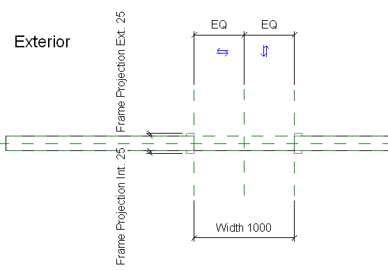

    The new family opens in the Family Editor. For most families, 2 or more dashed green lines display. These are reference planes, or the working planes that you will use when you create the family geometry.
    If you are creating a host-based family, host geometry may also display.
