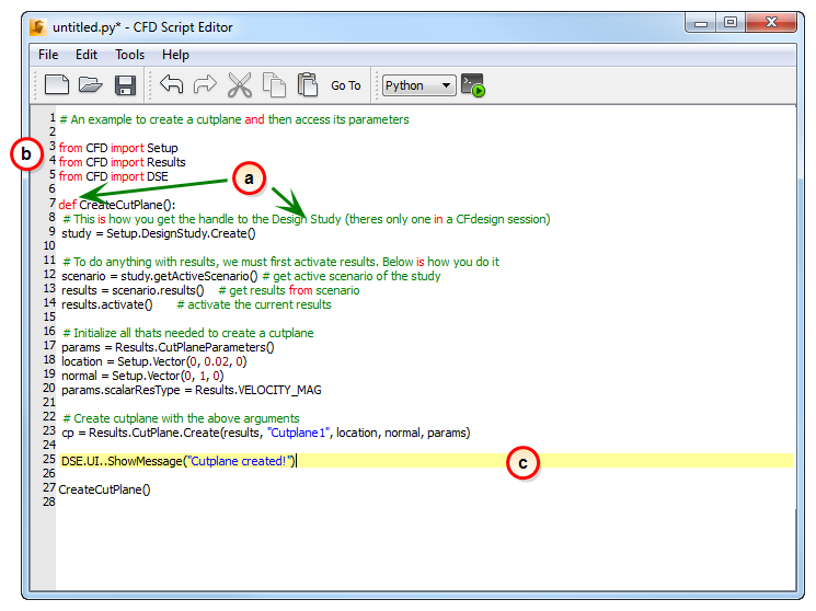

Text Region
The text region is contains several features that make text development easier:
a. Color-coding for several elements including variable declarations, comments, strings, and vectors
b. Line numbers
c. Current line highlighting
