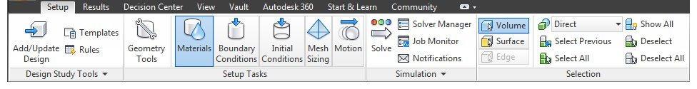

Setup Tab
Use the Setup tab to define and run the simulation model:
- Use Design Study Tools to update the Design Study and to manage Design Study Automation tools.
- Select each of the Setup Tasks, from left to right, to define the simulation. (Note that each task, except Geometry Tools, spawns an additional context panel.)
- Use Simulation to run and manage one or more simulations.
- Control entity selection with Selection.
Note: The Setup Tasks and Simulation panels contain the primary controls for setting up and running a simulation.
