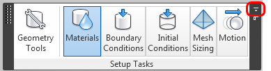

To return a panel to its default location
- Drag the panel to its position within the ribbon.
- Alternatively, hover the mouse over the panel until the border appears, and click the Return Panel to Ribbon icon:

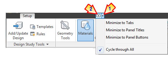

To minimize the ribbon
There are three ribbon minimization modes: tabls, panel titles, and panle buttons.
- To select the mode, click the menu arrow to the right of the tab labels (1), and select from the list.
- To minimize the ribbon to the selected mode, click the arrow button (2). To restore the ribbon to the standard configuration, click the arrow button again.
Note: To use the arrow button to step through each mode, select Cycle through All.
