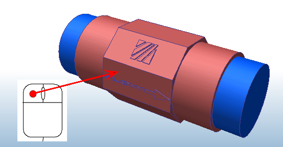

Assign Aluminum to Pipe Wall
Click Materials from the Setup tab:
Select the pipe wall.
Open the Materials quick edit dialog in ONE of the following ways:
On the Material quick edit dialog, Type = Solid.
Name = Aluminum
Click Apply.
