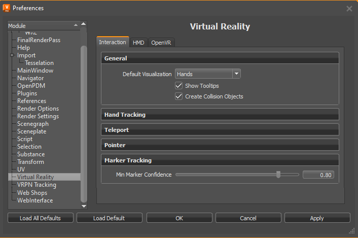

Use the Virtual Reality preferences to customize interaction setting for visualization, tooltips, object collision, and teleport, as well as eye tracking, foveated rendering, and StarVR use. These options can be found in one of two tabs, Interaction or HMD. Once everything is set, click Apply.
Use these parameters to set the default general, hand tracking, teleporting, and marker tracking interactions in VR.

The marker tracking system detects each marker and assigned a confidence value to it, ranging from 0.0 to 1.0.
0.0 means the system deems the detected result (marker ID and position) 100% incorrect.
1.0 means the system deems the detected result (marker ID and position) 100% correct.
For example, a marker that gets a value of 0.9 means there is a 90% confidence in the correctness of the marker's position and IDs.
A marker with a low confidence value appears to be jumping around. Setting the minimal accepted confidence to a higher value makes the system ignore unreliable detected results.
A marker that was detected with high confidence value, but later is detected to have a confidence value lower than the minimum value will be ignored and its position will not be updated.

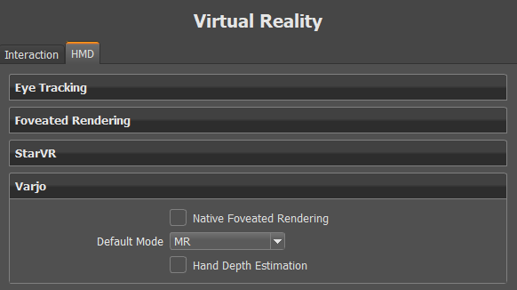

These options are specific to a Varjo HMD for settings the default native foveated rendering state, the mode you enter, and hand depth.
Once your preferences have been set, click Apply and OK to save these settings.
Hand Depth Estimation - Sets the default state for real-world hands in MR. When enabled, it detects your real-world hands in the mixed reality video and shows them in front of a virtual object, if they are closer than the object. When disabled, the rendering from VRED will always occlude the real hands, even if the hands are closer than the rendered object.
