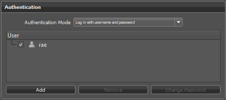

Authentication
Adds an extra layer of security, but requiring a user to log in and enter a password.
  • Authenication Mode - If you don't want any authenication for the Web Server, select No Authentication. To set a user and password and add another layer of security, select Log in with username and password.

  5. In the Authentication section, change Authentication Mode to Log in with username and password.
  6. Click the Add button, then add a username and password.
  7. Click OK. The new user will appear in the User section.

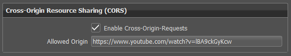

Cross-Origin Resource Sharing (CORS)
This features provides a way for a web application running on VRED to access content from another website, to do something such as play a YouTube video.
CORS in the WebInterface prefs
  • Enable Cross-Origin-Requests - Enables resources on a web page to be requested from another domain outside the domain from which the first resource was served.
  • Allowed Origin - Only available when Enable Cross-Origin Requests is enabled. Enter the URL domain to be displayed by cross-origin request sharing in the WebInterface.
