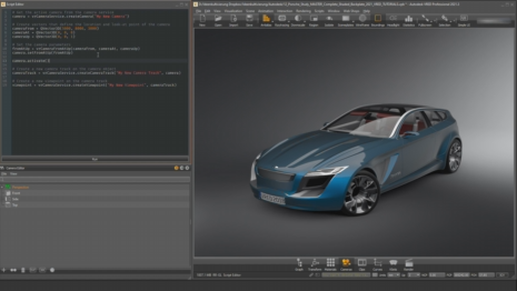

The Tutorial 6: How to Work with the V2 Interface Using Services and Objects video covers examples with cameras, viewpoints, and sceneplates in VR.

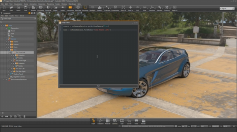

The Tutorial 7: How to Script Scene Object Transformations Using the New vrdTransformNode Introduced in VRED 2021.3 video covers examples with cameras and viewpoints, as well as sceneplates in VR.
The Tutorial 8: How to Combine the Old V1 and the New V2 Python Interface video covers examples of interoperability between the old vrNodePtr and new vrdNode object.

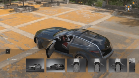

Learn how to customize the VR menu.

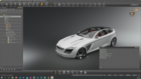

The Tutorial 12: Low Level Field Access with vrFieldAccess video covers the following: Basics (using Node Editor to look up fields) and advanced How to access certain more complex fields, such as fieldContainer in a field container (and so on, multiple levels) or list of field containers
