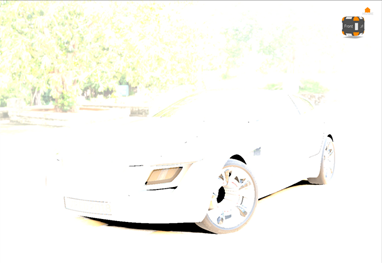

Enable Photometric Parameters - Switching from raytracing to OpenGL mode when using Enable Photometric Parameters and clusters no longer causes VRED renders to produce overexposed images.
| Before | 2023 |
The screen no longer turns white when using Enable Photometric Parameters and cluster OpenGL and Antialiasing.

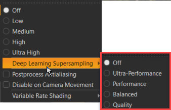

DLSS options (Visualization > Realtime Antialiasing > Deep Learning Supersampling) are not greyed out on laptops with Nvidia 496.49 driver installed.

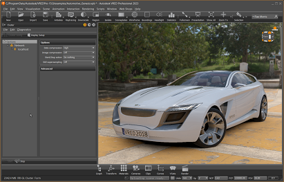

LeapC-SDK-relwithdebinfo-v5.4.3-ab422fa1-CI506955.C:\Program Files\Ultraleap\LeapSDK\lib\x64.LeapC.dll to :\Program Files\Autodesk\VREDPro-15.0\bin\WIN64 to overwrite it.Cluster Failure - A cluster will fail to start, if the last node is localhost in the cluster list.
Explanation: A pipeline and PCs at the beginning of the list need to reach PCs later in the list by the given Name or IP Address. If localhost is used, VRED tries to use the hostname of the master PC; however, PC 10.148.241.230 doesn't know GRED-P710 by name.
