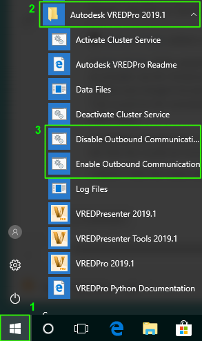

How to Enable Outbound Communication
Enable outbound communication to share views of your content with people outside of your organization.
  1. From the Windows Start Menu, scroll to the Autodesk VREDPro <version number> folder and click it.
  2. Select Enable Outbound Communication.
    Darksite Mode
How to Disable Outbound Communication
Disable outbound communication to protect your content from accidentally being sent to people outside of your organization.
Note:
Dark site mode is a configuration mode for the CLIC licensing service. When it is disabled, it does not affect other communication channels, such as VRED Collaboration, WebShop, Autodesk Analytics, or the Help Documentation.
  2. Select Disable Outbound Communication.
    Darksite Mode
