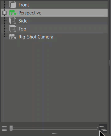

Opening a Second Tree
Open a second tree for searching and filtering cameras, viewpoints, and tracks. One tree is unaffected by changes in the other.
  1. In the Camera Editor, click-drag Section Drag to expose a second tree list.
    Section Drag
  2. Now, use the new tree for searches and filtering.
Tip:
Drag the slider at the bottom of the tree or click its buttons to expand and collapse the tree list.
Collapsed and expanded tree
