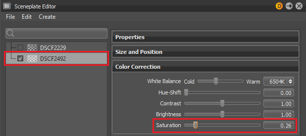

If the colored vanishing lines are hard to see against the backplate, try reducing the saturation of the backplate. In the Sceneplate Editor, select the backplate. Scroll down to the Color Correction settings and change the saturation, while doing the matching.

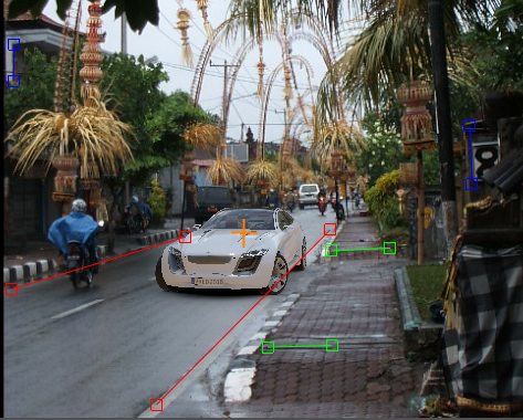

Correctly Placing Vanishing Lines
This example image shows how to correctly place vanishing lines in a scene.

Choose an option from the Vanishing Lines option to set the vanishing lines in your image. By default, the coordinate space is Z-up.

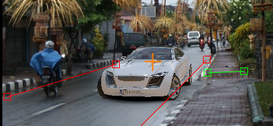

Position the X manipulators along a line in the X-axis, then the Y along the Y-axis. See Position Vanishing Lines Using the Magnifier for how to use Magnify Factor to precisely position manipulator handles.
Now, you can pan with your camera to position your object, move it forwards and backwards.
Use Rotate to rotate the object. Set the number of degrees, then use the arrows to rotate clockwise or counter-clockwise.

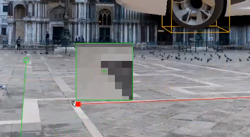

Shift-click a vanishing line to position it.
Shift-click the handle of a vanishing line to access the Magnifier. This provides a magnified view of the area around the handle to aid with placement.
Change the Magnify Factor option if you need more magnification.
Set a large value to see the area better and precisely place the handle.
