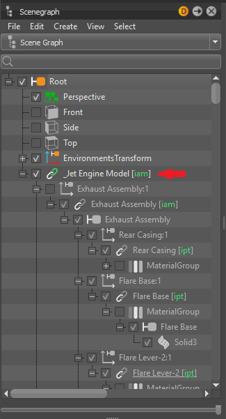

If the opened VRED project is a reference to a source file, then the root icon changes in the Scenegraph. The usual Scenegraph Root icon Scenegraph Root icon is replaced with this icon Reference Root icon. When VPBs are imported, the root is not replaced. The usual Scenegraph Root icon Scenegraph Root icon is used and the VPBs are added as children of the root.

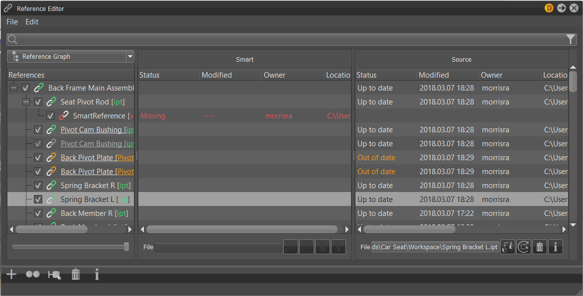

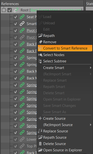

  3. Select Scene > Reference Editor to open the editor.
    Reference Editor
  4. Within the Reference Editor, select either the entire file or only the files you want to convert.
  5. Right-click and select Convert to Smart Reference.
    Convert to smart references
In the Smart section of the Reference Editor, new entries will appear and their status will be displayed as Unsaved, as they have yet to be saved.
Unsaved smart references
Once saved, the other fields, Modified, Author/Owner, and Location, will populate. The Source section will display an Up to date status, along with a modified date and file location.

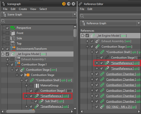

Working on a Smart Reference
When working on a smart reference, you can work with it in-structure or individually opened.
  • In-structure - With projects containing many smart sub-references, work directly on them within the Scenegraph and Reference Editor's Reference Graph. When a change is made, the reference will appear in a modified state, displaying an asterisk (*) in the file name in the structure.
    Modified sub-reference
  • Individually opened - Open and work on references within the Scenegraph and Reference Editor. References can be identified by the reference icon Reference Root icon and indicates the loaded files is linked to the a source reference file. When a change is made, the opened file will appear in a modified state, displaying an asterisk (*) in the file name at the top of the VRED window.
    Modified unsaved smart reference
Note:
If monitoring is enabled, when someone modifies a smart reference that others have loaded, the others will see no change to its status. However, once the modified smart reference is saved, the others are notified by a change in the reference's status from Up to date to Out of date (in orange text).

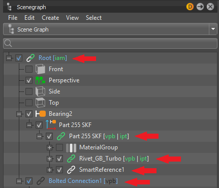

The loaded smart reference appears in the Scenegraph Tree View and looks like this:
Smart references in the Scenegraph
Notice the Root node is assigned a link icon Link icon. This is one of the differences when a VPB with a link to a source reference is opened in VRED. The next point of interest is icon colors, which indicate the status of a file. See About the Reference Editor for more information on what these colors mean and an explanation of the icon variations.

When references are out of date, this means changes have been made to the files by another user. To update the files, use (Re)Import. Once they are updated, their status in the Reference Editor changes to Up to date.
Updating a Smart Reference
  1. In the Reference Editor, select the smart reference files that need to be updated.
  2. Right-click, then select (Re)Import Smart. The Import dialog appears with a progress bar to indicate how long the import will take.
Updating a Source Reference
  1. In the Reference Editor, select the source reference files that need to be updated.
  2. Right-click, then select (Re)Import Source. The Import dialog appears with a progress bar to indicate how long the import will take.

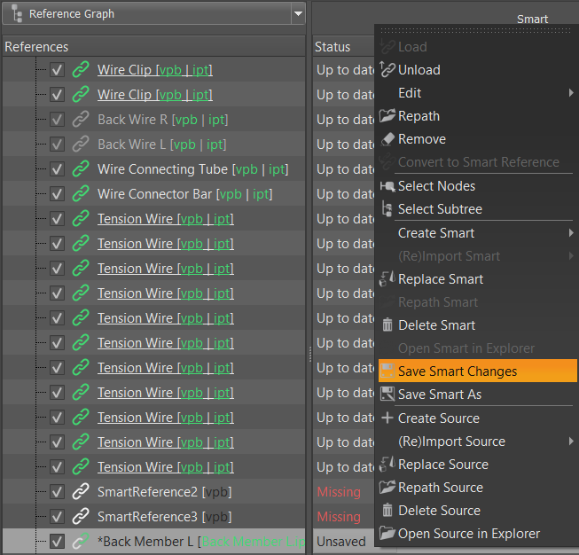

Saving Unsaved Smart References
  1. To save the smart references, right-click and select Save Smart Changes.
    Saving smart references
    A notification appears indicating that smart references are about to be created.
  2. Choose or set a location for the saved VPBs of the references:
    • Next to Source File - Choose this option if you have write access to the location where the source files are stored and want the smart references to be stored in the same area for ease of accessibility.
    • Custom - Choose a location where you have write access and want the smart references to be stored.
  3. Click OK, then Save.
    The smart references are converted, saved, and the changes (icon color, status, modified information, and location) appear in the Reference Editor.

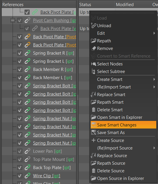

Saving a Smart Reference to a New File
Use Save Smart Changes As when wanting to save changes made to a smart reference in VRED and create a new file.
  1. To save a copy of a smart reference, select a reference smart-source reference, then right-click and select Save Smart Changes As.
    Saving smart references as
    A notification appears indicating the newly created smart references will be saved to VPB files.
  3. Click OK.
  4. Rename the file and click Save.
